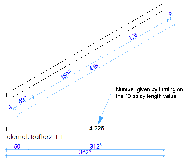

First, to explain what I need: I see actual rafter length as length from ends of element, not from points where it rests on beams or walls or similar. That's why I can't get any length that matches my need. I've tried several parameters in schedule setup but nothing worked. Only things I get are length of horizontal projection, length between resting places, or odd combinations of mentioned. Even turning that simple option called "Display length value" under parameters of Rafter2_1 11 (or any other) gives wrong number...
If anyone have come up with solution for this - please help!
I send in attachment pictures that will more accurately explain my problem.

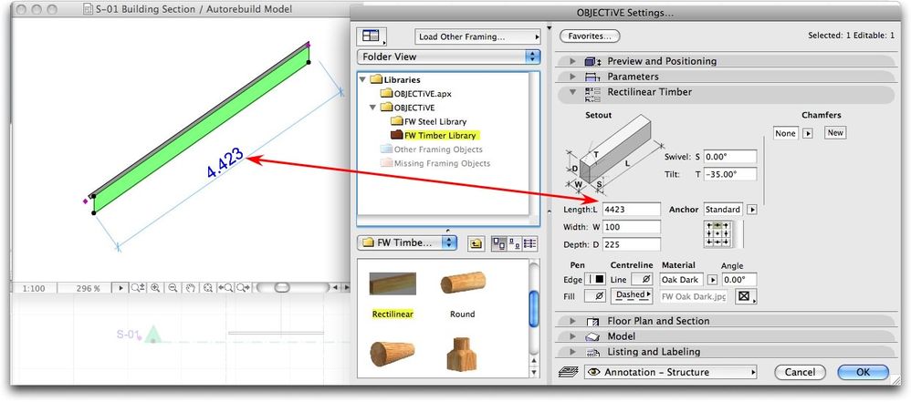

Take a look at OBJECTiVE and FrameWright. Both provide bounding size parameters that are always correct regardless of orientation or cutting. See the attached image for an example.
FrameWright may be better suited to your business because of its scheduling features, including (grouped) cutting lists, standard length increments, and time/cost/length allowances for shaping.

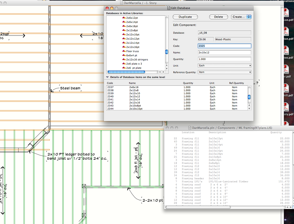

If you want to carry it a step further, you can easily calculate floor framing too. The set up is tedious, but you only have to do it once. You need to make property objects for each lumber size... Set up all the lumber sizes in the data base (since it doesn't come with them:(...ie. 2x10x10, 2x10x12.. 2x10x10pt, 2x10x12pt etc.. so, all the standard 2x6's, 2x8's 2x10's, 2x12's and repeat for PT joist. Then link each to a property object keyed to the ID field. Place the joist using the JOIST Beam object, and use the appropriate ID (2x10x12pt). I normally "slop" them on a framing plan view, unless I need to send it out, then I resize/stretch the joist before multiplying them so it reads right (not like the screen shot:) I actually keep all these objects pre sized and ID'ed on a template and copy paste them to the working pln. Pull you list via layers (floor 1 framing, floor 2 framing, headers.. etc.
You can download a sample list I end up with off my web site.
Good luck, it takes a lot of time to set up, but then it's done and easily used to generate very accurate framing list.
