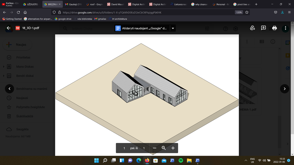

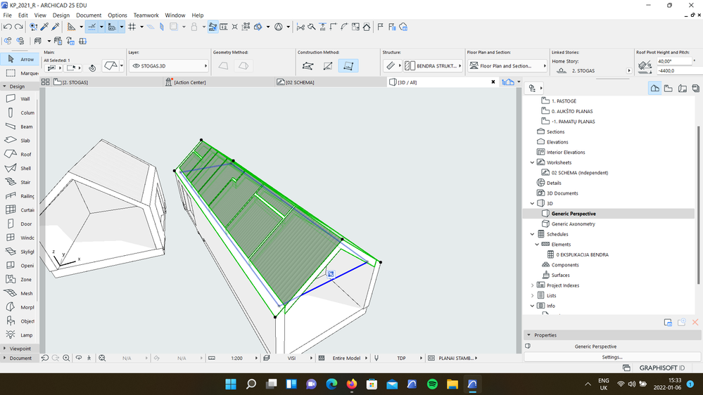

It could be that I didn't understand you correctly. It didn't work so I will leave screenshots below. The main thing is to extrude roof edge to the wall edge as shown in example (screenshot #1)
When moving pivot line the roof also moves. I want to leave the pivot line by wall inside face.
The other question is how to remove walls that are coexisting with roof (screenshot #2)

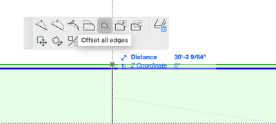

my guess is it's one of these options you are looking forScreen Shot 2022-01-06 at 7.54.52 AM.png
i'd go for offset edge any given day. just don't forget to pick the blue reference line. 😉

In your screen shot, the heavy blue line is the Pivot Line, the lighter green line is the Edge (perimeter) of the Roof. You can edit the Edge either in 3D or in plan by selecting it and using the Pet Palette options show by 4dProof to extend the Edge.
The Walls extending through the Roof could be due to their Building Material Intersection Priority (the Wall is stronger than the Roof). I have seen this before but cannot reproduce it now, so can you spell out the steps you took to connect the Wall to the Roof?
