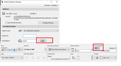

lmcardoso
back to this topic the master id its not an option for me.
I am using an text object with and ID to schedule the modules but need to be able to schedule if it is flipped or not
is there no way to make a property to display the flip of an hotlink or object?
