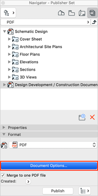

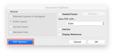

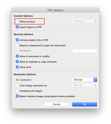

ARCHICAD users working in Bluebeam Revu will need to make sure that the PDF/A Archive option is disabled. If this option isn't disabled, content is not editable. Follow the steps below to disable this setting. 1. In the Navigator, enable on the Publisher Set tab and double-c...
