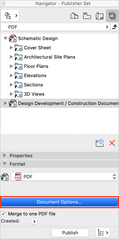

1. In the Navigator, enable on the Publisher Set tab and double-click on the set you will be using with Bluebeam Revu.
2. Select the PDF and under the Format tab click Document Options.

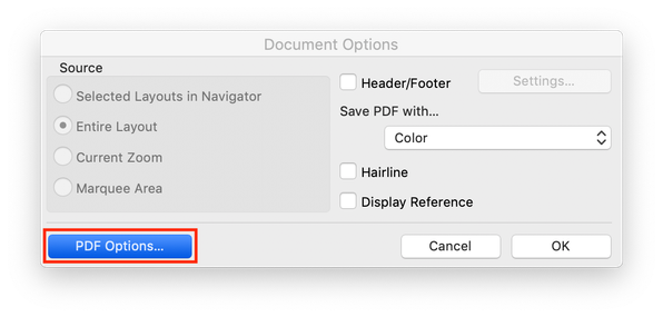

3. In the Document Options dialogue box, click PDF Options...

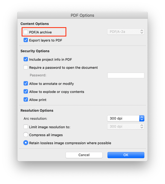

4. In the PDF Options dialogue box, uncheck PDF/A archive.
