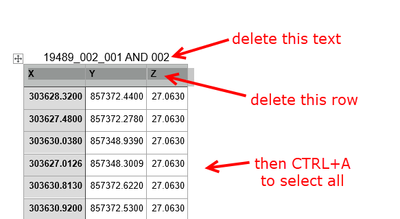

‎2023-11-17 10:50 AM
I really don't know as I rarely do this.
Maybe a spreadsheet program (like Excel) would be best?
But I don't think Excel can open a PDF.
Word can.
But with that new PDF you attached, I just opened it in Word.
Deleted the top 2 rows because they are not co-ordinates.
CTRL+A to copy all and pasted it into Notepad (I am on a Windows machine).
Saving as a .txt or .csv file from Word does not seem to work.
Saved that as a 'txt' file and imported it into Archicad.
Seems to work just fine.
As you said before all you need is the text file to be in the format of ...
x_co-ordinate[tab]y_co-ordinate[tab]z_co-ordinate[return]
