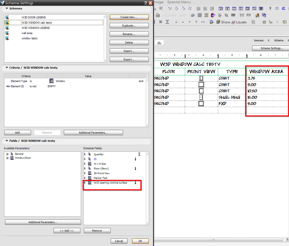

So think I found the parameter that will display in a schedule, the full window area, which for now is enough to satisfy me, [I'm running out of steam and need to get back to work!], and hope for more complete and detailed/accurate glazing only information later.

I have created this funky little schedule to do calculate areas, then I'll probably export it to Excel and run them, hopefully with an automated formula...
I haven't created or used schedule except for windows and doors. From everything I have on this forum they sound finicky at best, and my experience with doors and windows backs that up. They will do what you want so long as you're spot on with input, but the sheer number of parameters, and therefore opportunuiites to screw it up are anxiety provoking........with trimmed walls, even more I "dunno". I'll know more later I guess.
So, assuming I can trust my input and and AC's output.......a manual proof/check will have to be run a coupe of times before I trust either of us. My ability to input information correctly, and therefore get the accurate return information I'm after is still a question. I have read many a post about schedules giving inaccurate information and this leaves me very uneasy about just going with it.
