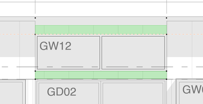

i have this wall with a metal surface override - I would like the lines of the metal to align with the window frames, how would i drag/ adjust the appearance of the surface?

I’d go into 3d view, make a slab that has a corner or edge where i want my texture to “start” then go to Document- creative imaging - align 3d texture and use the slab as a reference to click on and align the texture.
more on this: https://help.graphisoft.com/AC/28/INT/_AC28_Help/025_Attributes/025_Attributes-47.htm
