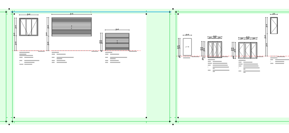

Hi there,
I am very new to ArchiCAD 24 and am having troubles with the window + door schedule not showing the relevant window and door heights in relation to GF level - see attached image. How can I 'lower' the left hand roller door to show on the same GL level as the right one - I am unsure where the office standards level reference is coming from. In the actual model they have both been modelled on the same level.

As far as I know it should be this setting in the schedule settings.
That you for your reply.
It appears that the window and door schedule was set up using CadImage rather than the ArchCAD schedule setting.
Any thoughts on how the issue could be addressed with the current format?
Sorry, I am not familiar with the CI schedules as I don't use them.

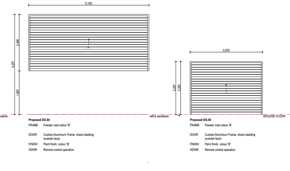

Hi there,
I believe that this schedule is set up as a CAD image, which I am also unfamiliar with.
Any help would be much appreciated!

@Vera D ,
I have merged your posts as they are the same question.
Somebody here may be able to help.
But in the mean time, contact support at Central Innovation and they should be able to help you.
