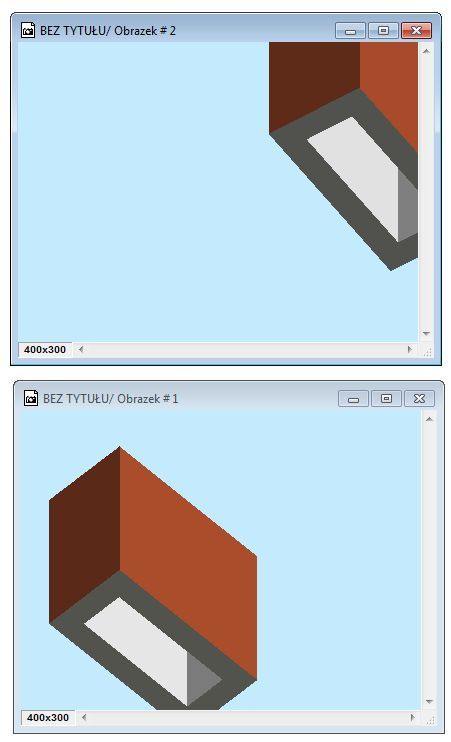

Tomasz Marek
Beginner
I think it clarifies it well enough.
Two 400x300 renderings of an axonometry of same model.
Without knowing the position I cannot replicate the view/rendering.
