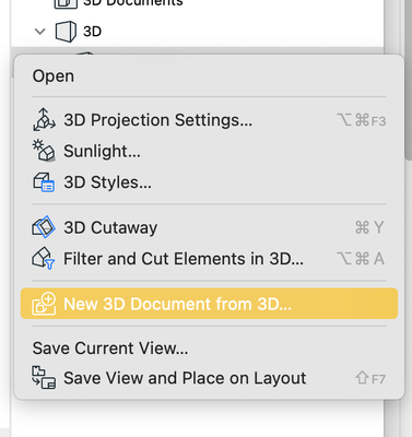

Have you missed the New 3d document from 3D option?
Right-click your 3d view and you get this option:
You get a vector line view like this:
Zero pixellation (as expected from a vector image) but you don't get image textures - unless I'm mistaken.
