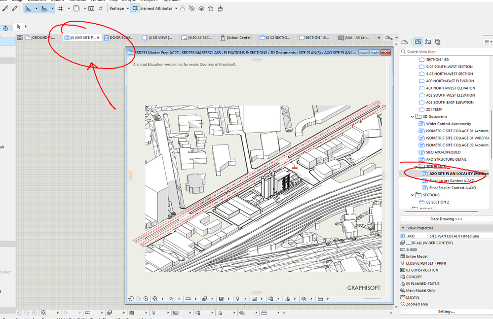

Hi there
My 3D documents have randomly started popping out in new tabs rather than in the tab bar as highlighted.. is there any preferences in work environment or project preferences for this ? I've tried to look at the options in the Window dropdown
thanks.
Lachie
Operating system used: Windows 12

lachiemckern:
Look at Work Environment > User Preference Schemes > More Options > When opening another View or Layout of a similar type: Open views in a new tab.
David
