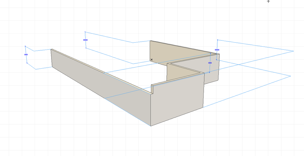

In the 3D document, the dimensions are acting very strange. They will offset some distance automatically, and sometimes even rotate the dimension that you want to get. The "offset" seems to be a new feature, but it shouldn't offset crazy distances by default.
Can we have a fix for this soon please?

Ok, I think I found out the problem.
BTW, this also messes up 2d dimensions' orientations as well.
Simply don't mess with "Display editing plane during editing operations only" setting in the "On Screen Options".
If you checked this option, simply unchecking it won't fix the problem. For new files, New & Reset All, and changing this option will fix the problem, but what do I do with all my existing projects?

ok, i traced it back to the work environment being imported over from previous AC version. it seems to work ok now with the standard WE, and with the correct grid (rotated) & editing plane settings.

Thanks for locating the source of this issue since it's been a headache with our floor plan dimensioning. Since we have already started several projects with that option checked, it would be REAL nice to figure out how to "reset" those started projects like you mentioned.
I'll try and monkey around but so far it appears that once a project has had that box checked, it's broken for good. Even with the standard 15 template and profile. And reapplying the scheme or profile doesn't fix it.

Yes I think gs should look at yhe overall dimensiin issues again. For this problem, for your grid, try to set custom grid as if you are setting a rotated grid, but just make it a straight custom grid.

Ah, thanks for the work-around!
