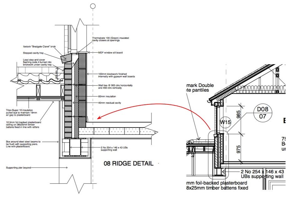

Take "live" sections from the model, keep these sections "live" as the basis for building your section details. Then add 2D linework and text as required to produce the final detail. Only destroy the 3D by exploding or making independent sections/details as the last resort.

Review your elements to make sure the line-work is as useful as possible without any "cover-up" in the sections. Attached is a section with the Complex Profile highlighted to show how far the 3D can go.

I model accurately enough in 3D to produce all my major sections at 1:50 without any 2D additions, i.e. I get sections to that scale with minimal effort.
When it comes to detailing, e.g. at 1:10, I always do this in 2D, but the basis for detail comes from the 3D model. When I place the detail marker, a copy of the model section is created in the detail, and I rework this to make a readable drawing. I say this because details are not a literal representation - they are an (abstract) illustration. Many elements are slightly exploded in a detail view to make the drawing easier to read.
