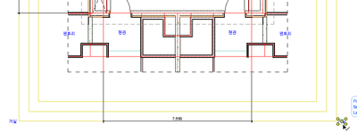

A zone stamp of "거실(living room)" appears outside the detail tool border.
LeeJaeYoung
I'm not concerned with the detail tool borders and zone stamps, but by the zone? Or is it a bug?

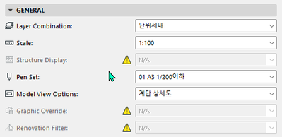

Q2.
There is Model View Options in Settings.
But when I rebuild, the option doesn't seem to work. Where are these settings available?

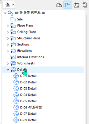

Q4.
How do you make the parent body of detail?
It seems to me that you have to do it after adjusting the environment every time you rebuild. Is this correct?
I thought that it would be possible to set the environment in the detail view and load it, but that doesn't seem to be the case.

Karl Ottenstein
I can't understand what is surprising you?   The zone stamp is fixed in its 2D location... which you have total control over (you can drag it wherever you want it to be).  In the case of your detail, your detail border does not include the zone stamp, so it will not appear in your detail.
I may not be understanding you - much of what you post does not make any sense to me - and so recommend that you contact your normal technical support channel, which is your local distributor of Archicad.
