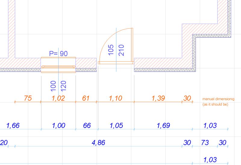

I have a problem with AC 13 Automatic Dimensionig. everything worked fine in AC 12, but now in AC 13 I can not get automatic dimensioning to dimension proper window opening (if I set windows with oversize- see attached picture). Orange dimensions are made manualy with the correct wall opening, blue dimensions are automaticly created exterior dimensions.
Does enyone know what the problem is? I tryed to check all of the settings (Nominal Size, Wallhole Size, Reveal Size, Unit Site), but nothing I do seems to make any difference- I always get the same value- window size.

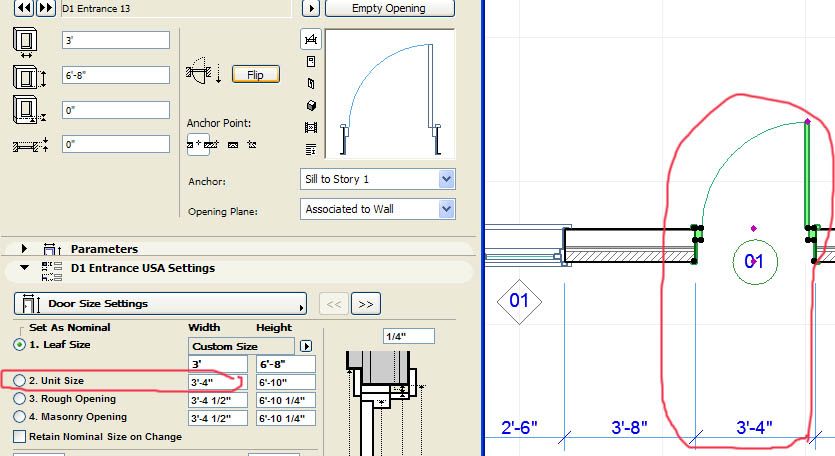

There are 2 diaglogue boxes where you want to coordinate the settings.
One is the Auto-dimenisioning (Document>Document Extras> Automatic Dimensioning) and the other is in the Settings box of the door or window itself.
See the following screen shots.
Erika
Architect, Consultant
Mac OSX 10.11.1
AC5-18
Onuma System
Erika Epstein
Here the unit dimension of the windows is the one we want to show in the auto dimension so there we had selected UNIT dimension.
Erika
Mac OSX 10.11.1
AC5-18
Onuma System
Erika Epstein
The door dimension shows the UNIT size of 3'-4", but I would rather it show the door PANEL dimension of 3'-0"
Erika
Mac OSX 10.11.1
AC5-18
Onuma System
Erika Epstein
Finally, I change the auto dimensioning for the doors to read the PANEL size.
alternatively I could have changed the UNIT size of the door to 3'-0". You need to think through when using the auto dimensioning, which dimension, the UNIT or the PANEL etc will be the most commonly correct size. If there are a few doors or windows that are not typical, then you can change the dimension string manually after setting the auto dimensioning.
