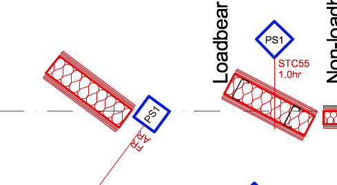

Bringing this post back from the dead - need diamond detail box for wall labels also - trying to learn how to rotate square labels, and/or learn to make the CW label rotate and stay locked to walls... per screenshots. Horiz wall behaviour - good. Rotate walls - my parameter mods go wonky.

wonky
