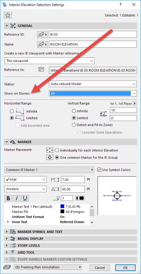

what gives guys? why do my interior elevation markers that I placed ONLY ON ONE STORY show up on ALL stories? please advise.

Any chance you haven't bothered to set the stories?

YES....that was it. didn't realize that even when you place an interior marker....you can designate on how many stories to indicate for that marker.................hubboy.

You can also apply that to section markers
