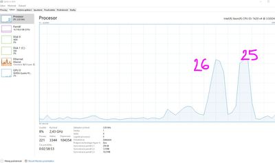

Hi, any news in this subject?
I have the same problem.
I compared AC25 and AC26, viewing the same project and both used same % of CPU and GPU, but AC26 had slower response while zooming or moving 2D view.
