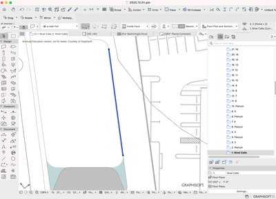

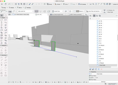

Hi! I have drawn a wall, and when i go to the 3D tab, the wall appears broken into parts. When i click on the wall, I can "see" the outline of the wall, but the parts in the middle are missing. I do not have any windows or doors placed, I simply created one wall.

Hi @adrianasofiasm_
It's hard to say with the information provided, but perhaps you used an opening or even a hidden element with a construction element that has a higher priority than the wall. Try displaying all layers, even hidden ones, to see if there's anything there.
