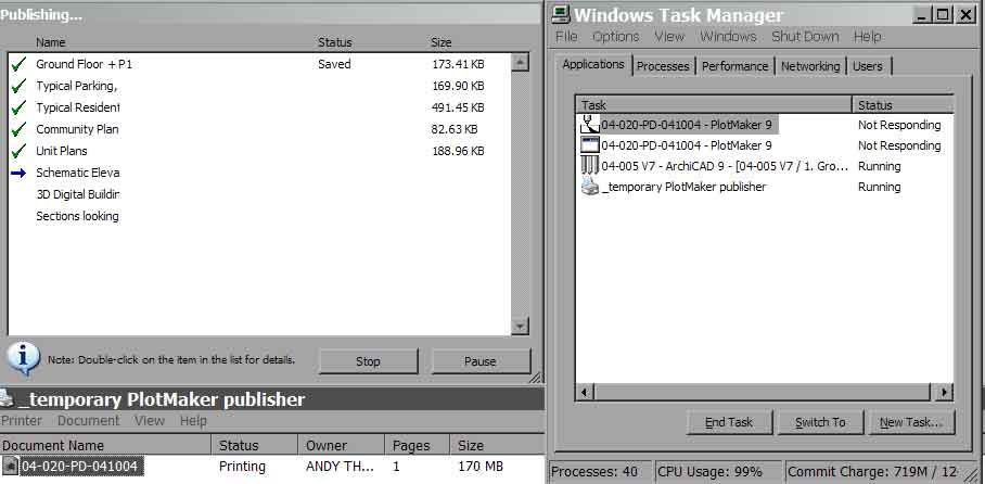

It seems that PM hangs when Publishing a set of PDF's when it gets to a page containing two JPEGs - they are only maybe 4MB each, and the original JPEG files are on a Mac server. I am working from a PC. I do recall a while back having to edit our smb.config file on the Mac's OSX to be able to save to the PC without my hair turning grey - I don't know if this is related, but my poor PC just hangs and hangs at full speed, see pic below...
As for the other PC desktop we are using, reinstalling AC9 did indeed work wonders, yes, the '_temp Plotmaker Publisher' shows up, and PDF is an option in the Publisher, however, when publishing a single blank layout to the desktop, it also hangs and hangs and hangs, doing nothing really but completely filling the processor with some mysterious task.
Please help! We need this to work! We are very dependent on reliable PDF generation!

4MB JPEGs are huge, so is a 170 MB printing task! It will take quite a few minutes to finish. The fact that the program got in not responding state does not mean that it will not ever finish the job. Since XP Microsoft introduced this fake 'not responding' white application window. This is misleading, IMHO, because it is just faked by Windows and does not report the status of your program, which is in fact running. It will do so for a long time, I'm afraid to finish the job.
Please check your JPEGs though. We are aware that Amyuni processes images very slowly if the color depth or some other parameter of the image is corrupt. It will process it, but it will take a lot of time. Re-save your JPEGs on windows in an image manipulating program (I think even Paint will do). That might help.
If you have a placed image on your master layout, publishing a blank layout might also hang. Try to publish an empty layout with one line only. It should work. Also try printng to the Amyuni virtual printer to see if it makes a difference.
