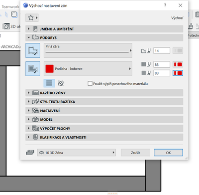

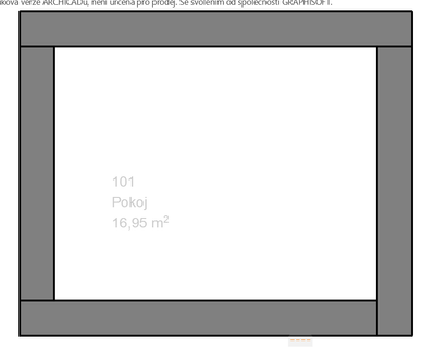

Hello,
I do not know how to change the colour of my zones in Archicad 25. My Zone (Cover) Fill Pattern ist checked, but the zone is still blank. It has been blank since default and I cannot find out what I am doing wrong. I checked all settings in zone tool.
1 Solution
jfaugustine
Did you check for Graphic Overrides, Renovation Filter, and/or Trace Reference settings?
ArchiCAD since 8.0, currently on 22, waiting on 26, maybe...
Go to post
3 Replies 3
jfaugustine
Bara3
Thank you, I tried Graphic Overrides, but I was am not exactly sure I did it in a right way.
Bara3
And I tried Renovation Filter and Trace Reference settings but it did not chage the colours of zones but then I tried Graphic Overrides again and it did work. Thank you so much.
