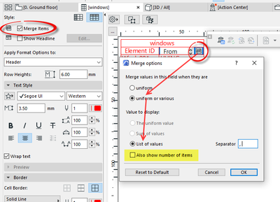

In version 25 there is a new option to merge cells in a schedule.
Add the 'Related Room Name' field and then make sure that you tick the box to 'Merge Items'.
Now in your column or row headings (depends how you have set your schedule up) the will be a 'Merge Options' button.
If you select 'Uniform or various' then the unique items in that row/column will be ignored and will simply list all the values in one field.
If you want you can add a count for the number of items as well.

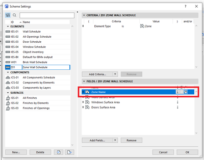

Try to use Zones to each room and later in schedule use the Flag option for Zone field in listing

Thank for the response. One request, can you show me the end result? I tried creating the schedule as per your setting but it didn't combined the Zone Names.

Solution
