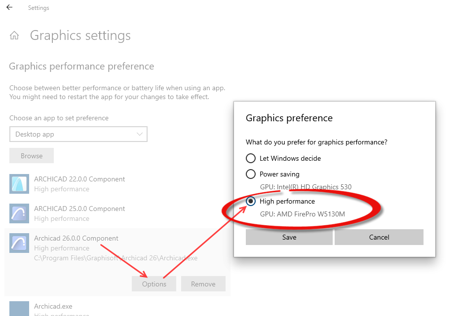

You say you specs are OK, but I hear the fans of your machine kick in when you dimension, which make me think your machine is having to work hard.
I am assuming you are using a laptop?
If so you will have a built in video card that Archicad will try to use but is possibly not powerful enough.
Go into your Windows Display settings then Graphics settings.
Set your Archicad program to use 'High Performance' settings.
I only have Archicad 26 and Windows 10 on this old laptop but you should see something similar to this.
You could also ensure your video drivers are up to date for both the built in and dedicated video cards.
