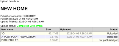

RandyC
Bimx will not publish Pages beyond 1st page of publisher set
even if the pages have no data - they come back as failed
     Any ideas ?

Do you get any more information when you double click the item that failed?
Or if you press 'Details' for more information?

Is it anything to do with strange or special characters in the names of what you are publishing?
I see you have a ".1 PLOT PLAN...."
I would avoid the 'dot' and use and underscore if you can ... "_1 PLOT PLAN...."

RandyC
  Clicking on the yellow warning triangle produces a screen that says it was not published
Clicking on the other one produces this......

What is the source of the schedule, is it a layout page or something else?
RandyC
The layout page contains , door schedule, window schedule and wall assemblies - "from schedules"
The entire page will not print to bimx even if I remove the "schedules" nor will any other page
of the publisher set if I add them to the layout  This is only occurring in this one file
   I am able to publish to pdf , dwg etc. just not bimx.
  Renaming layout pages does not work
  Printing blank pages will not work - so definitely
not the schedules
  Adding pages beyond the 2nd page will not work
              Strange eh ?

Have you tried creating a new publisher set for BIMx to see if that works?

Hello,
Thank you very much for the report!
I consulted with our BIMx expert and he said that probably there might be something wrong with the Master Layout, as you mentioned that even without the schedule, the BIMx export still failed.
If it doesn't help, I suggest reaching out to the BIMx support mailbox at [email protected] for further investigation, as we will need the file for a closer look.
I hope this will help you with the case!
