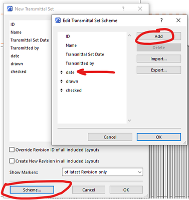

I need to re-issue the first issue with all the layout. I can then recreate the subsequent issues. the problem is how to change the issue date ?

THanks where do you manually type the date. What happens with the transmittal date then?

I meant what happens twith the transmittal set date?

when you create a New Transmittal Set:
  • click on Scheme
  • click Add
  • create a new field for the issue date
you won't be able to delete the Transmittal Set Date as this is hard-coded into the program. you can simply choose not to use this field in your Revision History Objects for your title blocks & instead use the Date field that you created.
keep in mind that you now have to manually type the date before you publish anything.

the Transmittal Set Date column in the Book Settings will always show your system date (computer date). i tend to ignore it as we only go by the manual date field.
