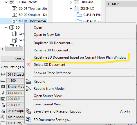

I would like to change the sun position in a 3D document I created from the floor plan. Is it even possible?

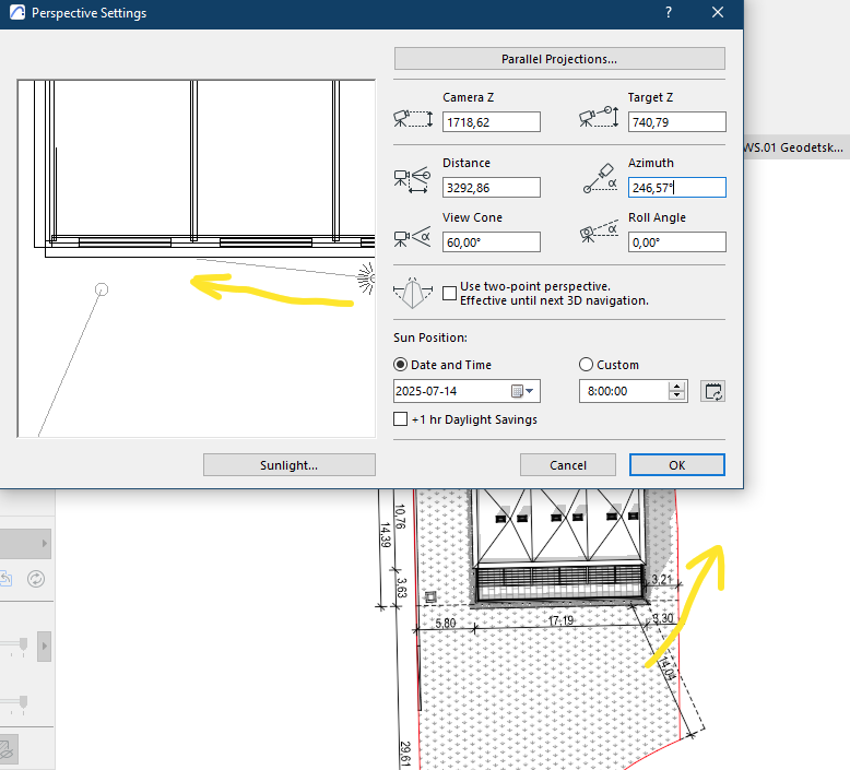

The 3D Projection tab is greyed out and I cannot get to the 3D projection settings that way. Under Sun tab, it is specified that I have to go to 3D projection settings to change it. But when I go to 3D projection settings "manually," via menu option...
You can see that the 3D document does not respect the 3D projection settings. I really don't want to create a new 3D document AGAIN, with predefined (and non changeable) sun settings.
Is there really no way to force ArchiCAD to recalculate shadows for a new sun position?

Think of 3D Documents as a photo - a snapshot of the 3D model.
You can make minor changes (delete and change elements), but you can't really edit or create elements.
You must open '3D source view' to get the same 3D model, then edit that model and then redefine the 3D Document.

It seems that, to redefine Sun position, one must redefine view from the exact floor plan, after adjusting the Sun position in 3D projection settings.
I hope this helps someone. And I also hope that this will make more sense in AC29. It isn't intuitive the way it works currently.
