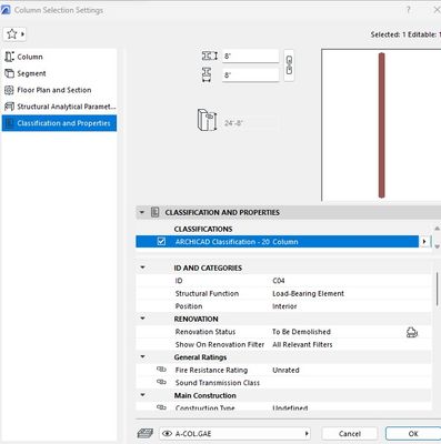

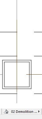

 How can I make column with a reno status "to be demolished" show with hidden contour lines?

It may be dashed but the scale of column sizes is small so you may need to adjust scale of the line type.

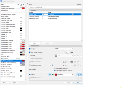

Hi! you need to add renovation status as one of the criteria

Below is a screenshot with the new settings: I chose dotted line, but the line type is not reflecting on the drawings.
Any advice?

I have added the reno to the criteria and change the line type, but the column still shows with solid lines.
Any suggestions?

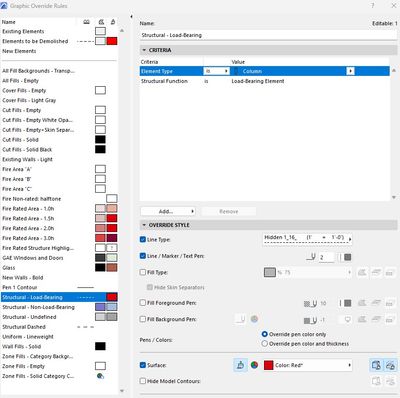

This is the setup for the rules. How are you setting up the actual rule combinations for the graphic override?
I would:
-check if you dont have a rule above this one that have precedence over this one.
-check the graphic override is correctly applied in your view via the through the View Map
