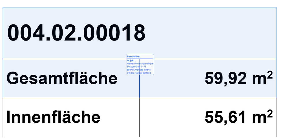

I`m trying to make the stamp show the surface in square meters of the apartement and the balcony, and also the surface of only the apartement (without the balcony).It`s also important for me to show an individual ID for every apartement in the top stamp. so in the end all room stamps with the same id will be there for the top stamp. my actual solution is to say to the room stamp of the balcony has the same id like its apartement. but in the options of the top stamp i couldn`t find an option to show the surface in square meters without the balcony. Does anyone know if there`s an option to edit this in the top stamps? it should look like picture 1 but there are 2 stamps. Screenshot (117).pngScreenshot (118).png

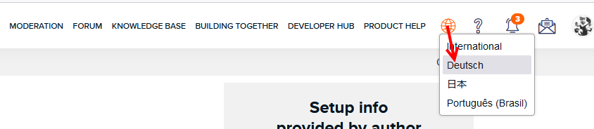

PS: I´m new here and i`m german. is there also an only german forum?
Yes, Top right of the page, you can change to the German forum.
