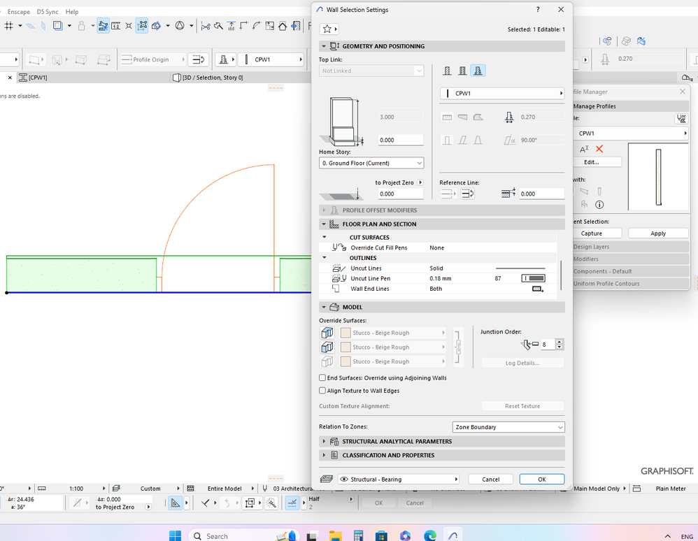

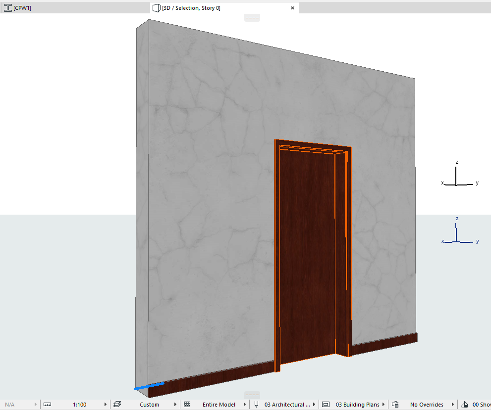

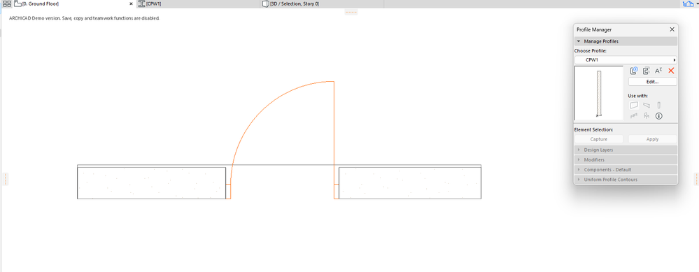

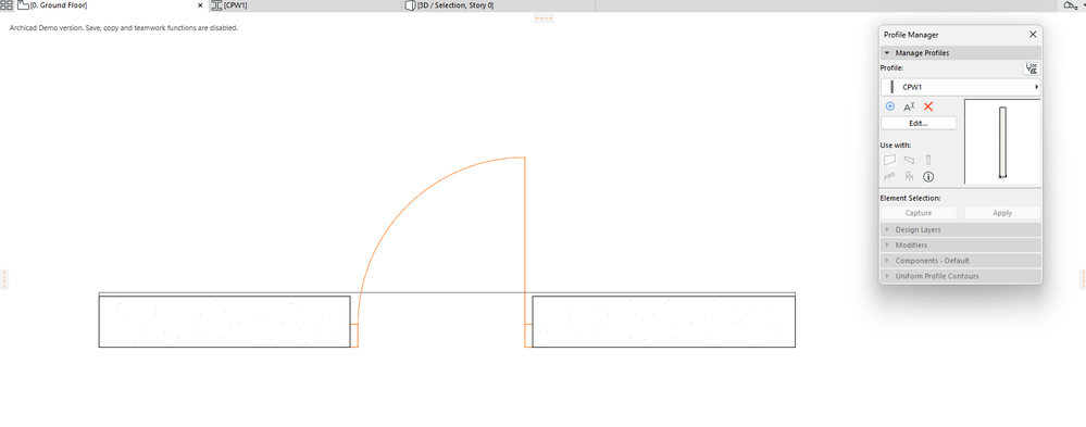

I've noticed something strange while modeling a complex profiled wall with skirting,
the strange appearance in 2D View as the wall has no end lines and the door frame lines are not there.
When compared it with the same profile in versions 26 & 25, I found it working well in the two, the 2D problem is found only in 27, so is it related to the update 5003? I think so.
1) In v.25 (7000), the 2D View is correct:
2) In v.26 (6019), the 2D View is the same as 25:
3) In v.27 (5003), here's the strange behaviour:
**Despite the three profiles have the same BM & 3D appearance:

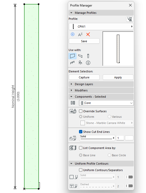

2024-03-14 09:12 AM - edited 2024-03-14 09:13 AM
There is a similar setting in the complex profile setup.
Select each skin fill and turn on the cut end lines.
2024-03-14 07:30 AM - edited 2024-03-14 07:30 AM
Is it just the end line setting in the floor plan and section settings?

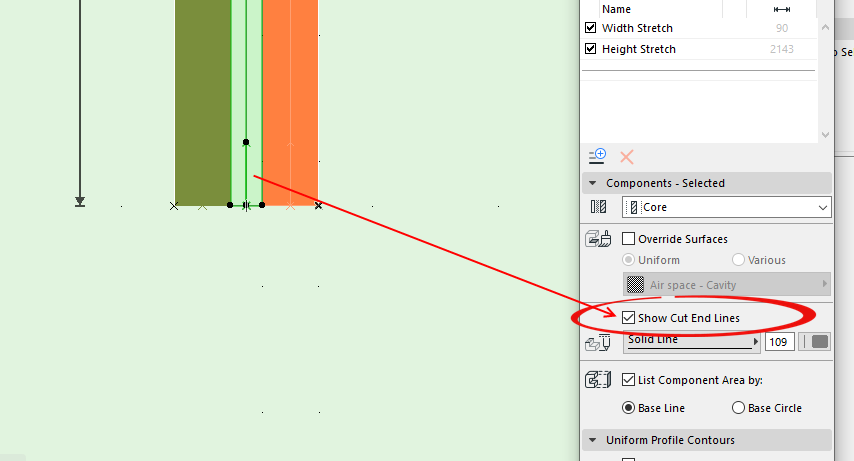

2024-03-14 07:52 AM - edited 2024-03-14 08:19 AM
Hi @Mahmoud Qenawi, if it’s not that, is it the wall end lines ? I had a similar problem in AC27 with my door and window edges being white. I had to turn on that tiny tick in the composite settings representing the cavity. I spent hours looking through other line settings.

2024-03-14 08:30 AM
Hi @mthd,
Yeah I got your trick but as you say it's in composite walls not complex profiled as in my case.
2024-03-14 09:40 AM
Another sneaky hiding spot for line settings to keep in my already overloaded memory 😆.
2024-03-14 09:55 AM
Yeah, That's it, I don't know how the pen color in the pen set changed to be white.
Thanks Barry & @mthd , I'm happy I've learnt this interesting info.
