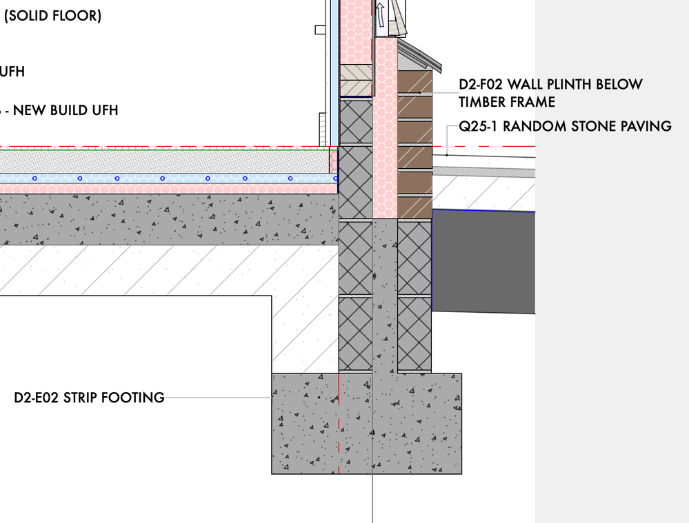

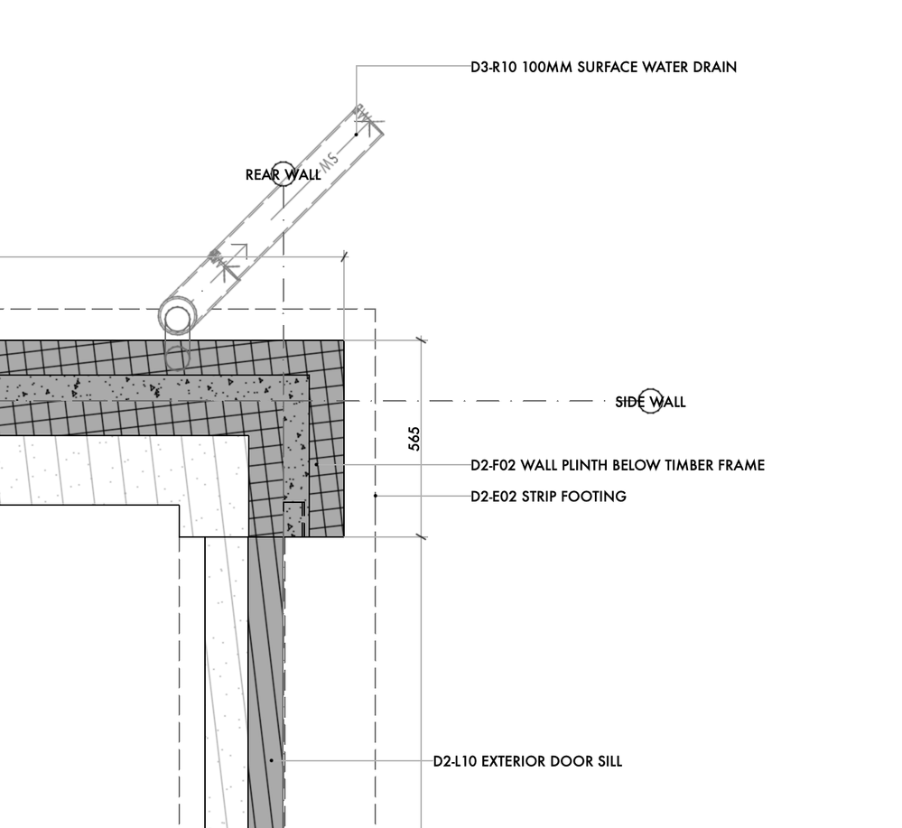

I do my foundations as 2 wall. One wall is the block construction below ground floor and includes the dpc and floor edge insulation, the pother wall is the footing itself.
I set the floor plan cut plane through the block wall so that the footing only shows in outline, which is the way I would have drawn it in 2D.
The other thing I find useful is to split the footing wall complex profile into 2 fills along the gridline setting out point. Change the edge line of one fill to match your gridline linetype and colour and turn the same edge on the other profile off. That way when you are locating the footing in section you can easily align it with the gridline.
