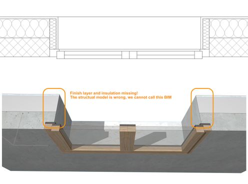

I love Archicad but there is one specific topic that has been causing me headaches for many years. It seems that you do not recognize this as a real and important issue but I'd like to know if we can hope to have a solution soon because it is impacting us negatively on more and more projects.
My problem is that layers of composite walls that "turn" on windows and doors are only displayed correctly in the 2d symbolic view. The 3D model cannot be modeled correctly with a finish or insulation turning inside a window.
I've made 2 simple examples that you'll find attached to illustrate my problem :
Example A is very simple, with the external finish being turned toward the window frame. The 2D is perfect but the turned finish layer does not exist in 3D.
Example B is a little bit more complex. The windows is aligned on the interior side of the wall and we have to add an insulation layer and a turned finished layer.
This is even more absurd as you can display it correctly in symbolic plan view but not on sections as they are purely 3D drawings... How can an Archicecture tool not handle this correctly? Yes I know, it's because of GDL and because there is a symbolic plan view and sections are 3D views... That is not an explanation. We need a 3D tool that is a real 3D tool. Not a mix of 2D and 3D.

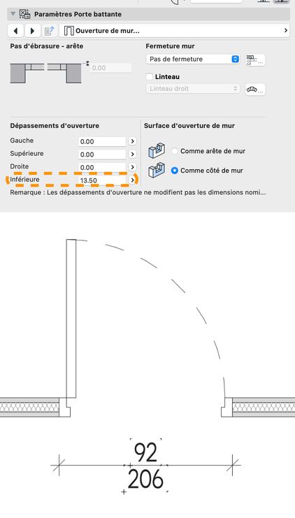

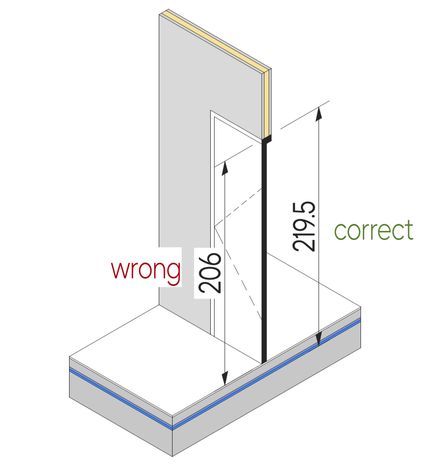

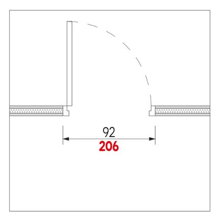

I'd like to add one additional topic regarding doors and windows that emphasizes the weakness of these 2 tools :
Archicad doors do not let us create the appropriate dimensions in plan.
In our country (maybe we are the only ones to do this), we must give the door opening size taking into account the total thickness of the floor complex so that the mason (or plasterer) can create the appropriate opening from the concrete slab.
Here's a quick example :
We need to create a dimension with a void height of 219.5 (from the concrete slab to the top of the door opening) but it is impossible in Archicad...
Edit : the only solution is to use a functionality of the doors to extend the opening but doors but there is a GDL bug in the doors that makes it not work properly...
The consequence?
1) Some colleagues have forgotten this problem in the past and ended up with several dozens wrong door openings that the mason had to cut and repair so that the door could fit in the wall...
2) We create complexe and error prone properties to handle this and put linked text in the doors... Again, hours spent correcting a software weakness....

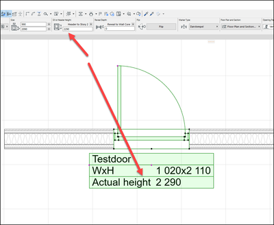

Kamelite
I know this is a long shot, but wouldn't it yield correct information if you put an offset to the door that matched the thicknes of the floor?
Even better would be to model the floor in each room?

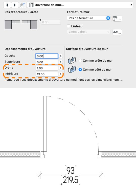

Johan Cosandey S22
Hi Kamelite,
The offset does indeed almost bring a solution to this problem but there is a bug in the GDL of doors... (I tried explaining it in my previous answer but my English is not always as clear as I want 😅).
If you only put an offset under the door, the dimensions won't show the correct height of the openning, no matter what you do.
You need to put an offset to at least one side if you want dimensions to take the bottom offset into account... (we already transmitted this bug to Graphisoft but the answer was that it is not a priority...)
Here's an illustration of this behavior :
We made a variant of this consisting on putting a 1cm offset on the right-left-top sides (corresponding to our fabrication margins) and put the height of our floor complex as a bottom offset. It works but creates a "void" on the side and top of the door which is not working graphically in some instances.
What is baffling is that the GDL object is aware of the height difference between the door and the bottom of the wall but dimensions cannot access this information.

Kamelite
Do you meen something like this?
Here, the actual height is reflected in the Doortag...
