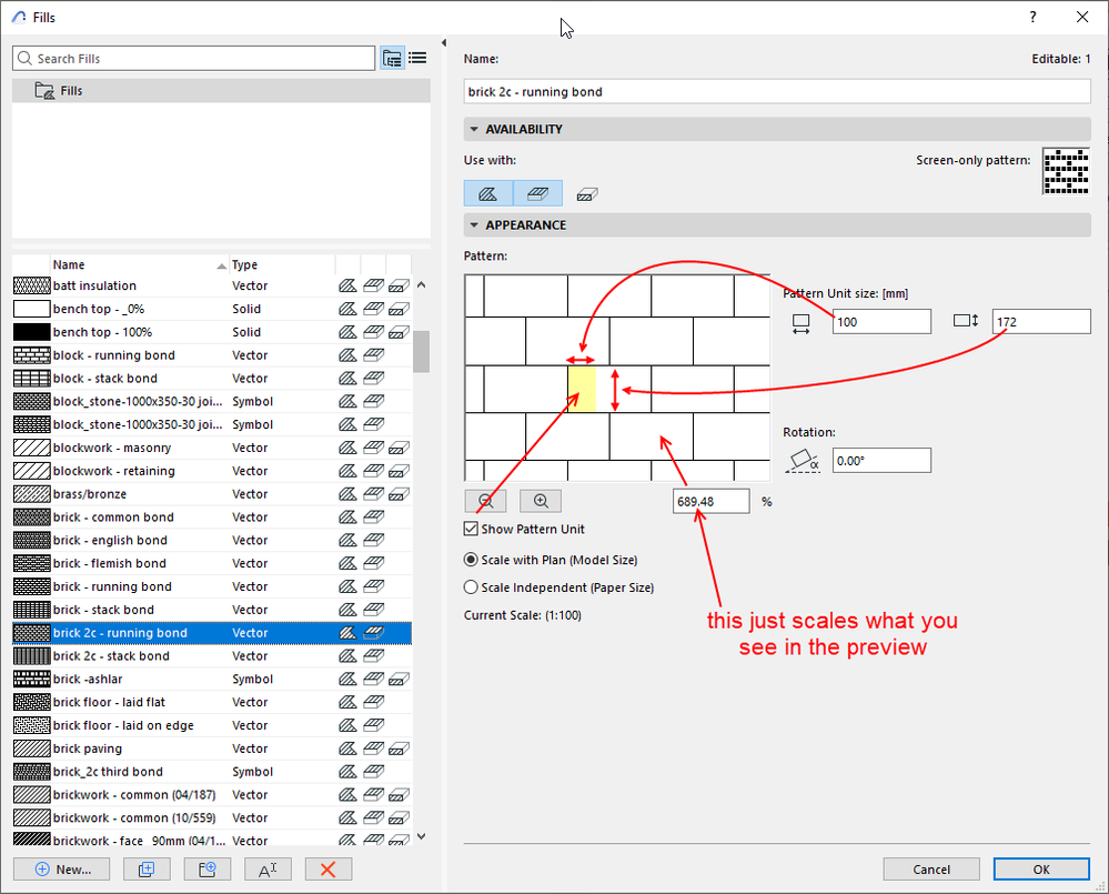

Hi, I was trying to create a new fill pattern from an existing one by copying it and renaming it of course. I used a brick soldier course stack bond but I wanted it to be a different size brick. I changed the percentage to 100% but it doesn’t keep this percentage locked in place. Anyone know how I can set and lock the percentage in place ?

Look at the yellow unit size.
In my example above the height of the unit is exactly the height of the pattern - so you would put 58 for the height.
The width of the unit is 1/3 of the pattern, so type 1/3 of 297 for the width or 99.
If the unit is half the size of the pattern then type 1/2 of 297 or 148.5
5 REPLIES 5
That scale in the fill settings has nothing to do with the fill itself - it is just for what you see in the preview.
The pattern unit size is what you want to adjust,
The pattern unit is the yellow highlight if you turn it on.
Adjusting the size of that is what adjusts the pattern size.
In this example my brick pattern will be 300mm wide by 172mm high.
mthd
Hi Barry, that’s what I did with the stack bond brick but for some strange reason the horizontal lines changed but the vertical lines didn’t ? ? ? Using a stack bond brick of 287mm long by 48mm high or to allow for the mortar joint, I just went for 297mm x 58mm for the pattern. I’m not sure but I might just try edit a default tile pattern or create a new fill from scratch if that doesn’t work ?

Solution
mthd
Thanks Barry, it was a quarter in my case and that worked to nearest mm but to get the next decimal place I would have to change the project settings mostly likely.
Certificate IV Architectural & Building
Technology, (Estimation & Administration).
You can type the decimal value and I believe it will use it.
It just won't show it if your working units are not set to show decimals.
It will show it as if rounded but I think it still actually uses the actual decimal value that you type in.
