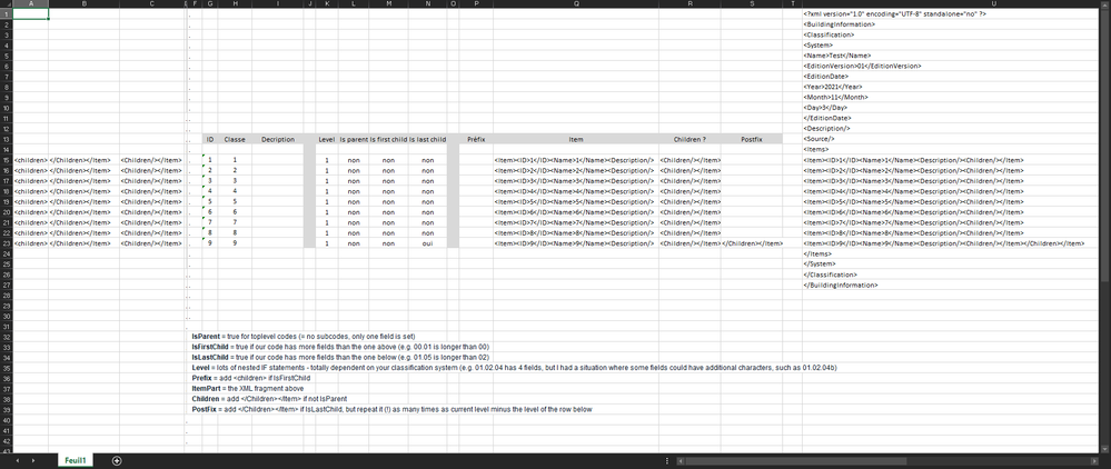

Ahmed_K
Mentor
Hello again !
I did this, but it didn't work, i followed all the formulas,
I even opened in notepad++ a classification generated from Archicad to see how it's structured,
I created the SAME structure in excel, ( i checked similaritie using a formula )
when i copy from excel to notepad ++ , save, and reimport in Archicad, it says corrupted xml file,

stefan
I can only recommend to work in smaller parts. E.g. one item first and see if that works. I had issues with encoding (accented letters etc...), with missing attributes (name? description?). So start simple and work from there. Unfortunately the importer is not that helpful with its error message.

Ahmed_K
Mentor
That's what i did, i worlked on smart parts, and thn , i made it larger with more sublevels, each time i find random results,
a good classification generator inside Archicad would be helpful
