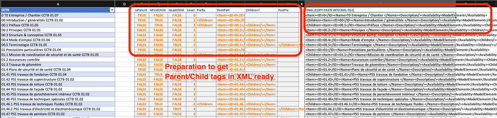

I've created Archicad Classification files in the past, from Excel. I started from an existing system in Excel and added a few formulas to turn them into lines of XML, ready to paste into a clean ascii document. This can be loaded in Archicad.
There was some trial and error involved to also have the tree included, to be honest. But much faster to prepare in Excel.
If the "tree" is not too long, you can simplify things by only preparing a flat list and create the tree inside Archicad with dragging and dropping items onto branches. And then export the XML again.

I had to include many steps to turn the "text" fragments into more structured numbers for branches & leafs. Formulas like LEN, RIGHT, LEFT, FIND etc... - easier to manage if you spread them over multiple columns.
This is totally dependent on the breakdown structure you are using.
I had to split a string like "02.21.1b planning des travail CCTB 01.02" into
  • Code = 02.21.1
  • Description = Planning des travaux
  • Backcode = CCTB 01.02 (which I needed to know how many characters to remove at the back of the string)
Then I had to "escape" some characters (like > < and &) to reach valid XML.
Excel SUBSTITUTE formula to the rescue.
Then a concatenation into an item XML fragment (the dots were the code and description which I just extracted).
<item><ID>...</ID><Name>...</Name><Description/><Availability>ModelElement</Availability>
Then deep parent/Child trickery to understand from each line, based on the "code":
  • IsParent = true for toplevel codes (= no subcodes, only one field is set)
  • IsFirstChild = true if our code has more fields than the one above (e.g. 00.01 is longer than 00)
  • IsLastChild = true if our code has more fields than the one below (e.g. 01.05 is longer than 02)
  • Level = lots of nested IF statements - totally dependent on your classification system (e.g. 01.02.04 has 4 fields, but I had a situation where some fields could have additional characters, such as 01.02.04b)
  • Prefix = add <children> if IsFirstChild
  • ItemPart = the XML fragment above
  • Children = add </Children></Item> if not IsParent
  • PostFix = add </Children></Item> if IsLastChild, but repeat it (!) as many times as current level minus the level of the row below
Finally concatenate the Prefix, ItemPart, Children and Postfix strings into an XML fragment.
And then, on a separate tab, I also prepared the header and footer of the document.
But you could also just start from an existing one or edit that directly inside Archicad.
Yup... That's about it.

it works , with a simple exemple,
now with this classification test it fails,
i think the PSTFIX column is the tricky one, jumping from level 3 to level 2 causes problems,
Here is the formula i used in the prefix column
=SIERREUR(REPT(SI(L7="T";"</Children></Item>";"");M7-M8);"")
