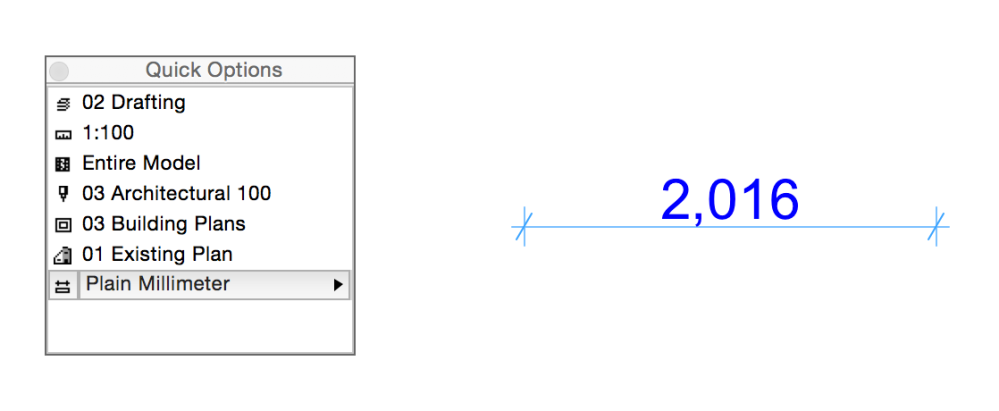

Decimals and Digit Grouping
Ever wanted to change how the numbers appear in Archicad, but could not find the settings in the Dimension Preferences? By default all numbers are showing commas for digit grouping and full stops for decimals.
This can be very easily changed in the system settings of your OS as Archicad uses the global settings.

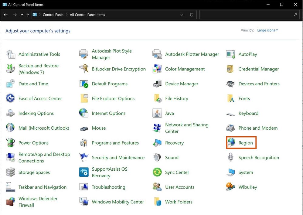

On Windows

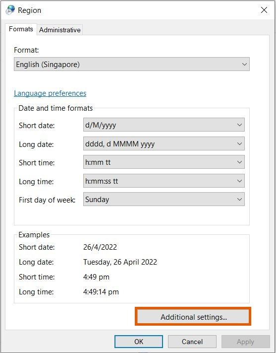

Open the Control Panel/Region and Language.

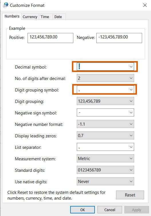

Click Additional settings… in the bottom right.
Set Decimal symbol and Digit grouping symbol respectively and click Apply.

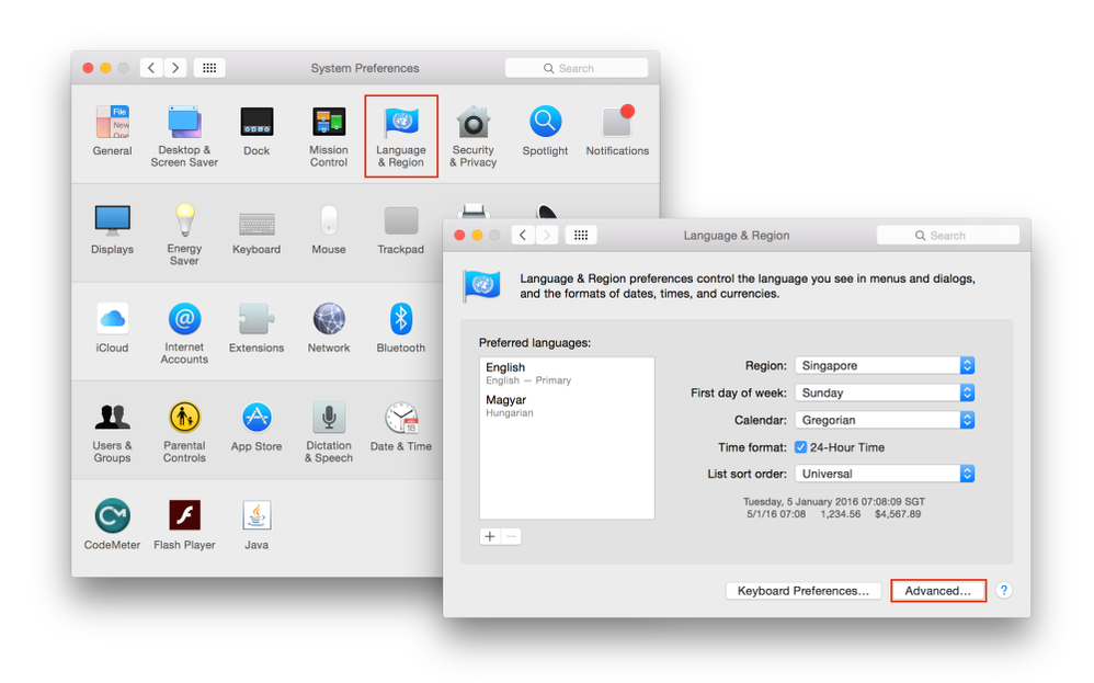

On Mac

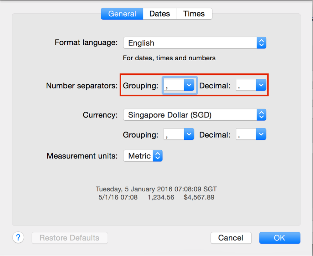

Open System Preferences/Language & Region and click Advanced…
Set the Number separators and click OK.
