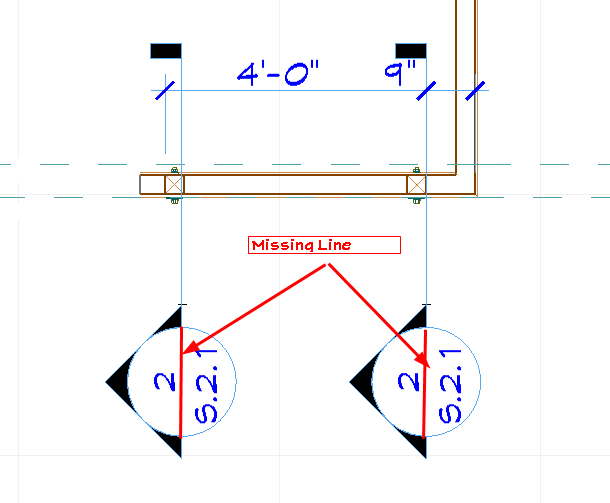

Detail Part Marker 14 - missing line
The Detail Part Marker NCS_14 seems to be missing the line between the Drawing and Layout ID.

Jay,
It is missing in AC 12 too. I wrote the attached part to address the issue. Note that this does use the Graphisoft macro "Marker Link Parameters". I don't know if this has changed in any way for AC 14. If so, it might cause problems.

vfrontiers
Does it also fix the missing line in the SECTION LINE type of Detail Marker?

Erich
Duane, There is a double flag option if that is what you mean. But this is a new object not a rewrite of GS's detail marker, nor a rewrite of their macros.
