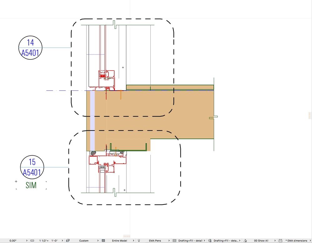

I'm having a problem with the detail marker tool. For some reason after the 2D detail has been created I have no access to the view settings for the detail and as a result i have no control over the appearance of the detail on the drawing. I'm guessing it must be a simply setting that i must be missing, but i cant figure out what it is or why the view graphic override and model view options are locked.
1 Reply 1
Edi
I agree, I don't understand why I am locked into a graphic override combination forever on a detail. Most common issue - if I have a uniform line weight GO when I create a detail, then I can never use lineweights for that detail. Is that how it is supposed to work?
