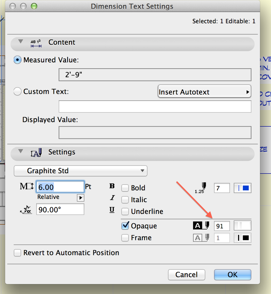

Can anyone else replicate this behavior?
Place a dimension.
Select the text
Turn on the opaque background
Directly enter the background pen color (in the box not selected from the pallet)
Did the color change for you? It will only change for me when I select the color from the pallet.

I'm on the same version of 16 as your signature and opaque background color works from number selector just fine.
Are you on Hotfix 3270?
Update:
Just installed 3270 and it has the bug, but I don't have the problem with 3014.
I can confirm that it does not work if you manually change the pen number in the text settings dialogue box.
If you pick the pen colour from the list or type the number in the info box then that works fine.
This is with the latest hotfix as well.
Katalin Takacs
Graphisoft Alumni
Graphisoft Alumni
Thanks for your report, we entered this issue to our defect database.
