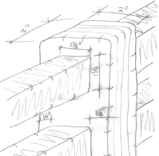

David wrote:Thanks for the nice tip David, but I am unable to dimension the model perfectly, do I need to rotate the model more precisely to get exact dimensions?

Djordje wrote:The Dimensioning Tools can be used in the Detail window. I think this is the best location for this type of detail that is not part of the live model.
(storey or S/E - NOT the detail view, as you need dimensioning).
Srinivas wrote:You should check your settings in the Parallel Projection Settings dialog box. Make sure the "h" values match, and that you have selected a predefined Axon view (not custom). If your view comes from Orbiting around, these values can be strange.
2007-02-11 05:23 AM
David wrote:You are right; even the marker can be placed accordingly. And there are no existing dimensions not to be transferred.Djordje wrote:The Dimensioning Tools can be used in the Detail window. I think this is the best location for this type of detail that is not part of the live model.
David wrote:Correct.
