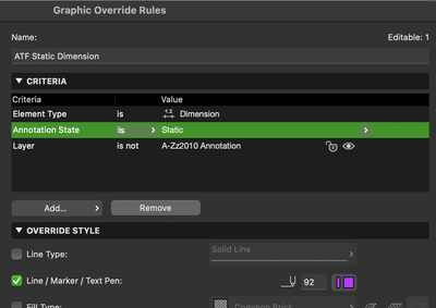

I am guessing you might already know this arrangement to check for non-associative dimensions using GOs...
I use it in all my GO Combos where I might be dimensioning.
