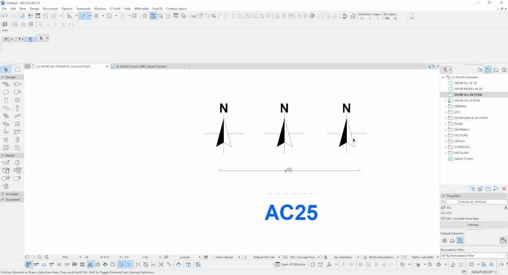

In Archicad 25 (~26) and earlier, when you rotate a North Point (Object), the Project North changes also.
However In Archicad 27, it appears you are unable to rotate the North Point manually.
I'm not sure if this is an intended change, something I've missed in updating our template, or perhaps even a bug.
Any ideas?

In AC27 project north is graphically controlled through the survey point functionality - set project north :
Josh Verran
Hi there, thanks for the response.
I was able to use the same method as you've shown above in AC25 too.
It's just that the Norht Point rotation from my GIF is quite handy and familiar.
