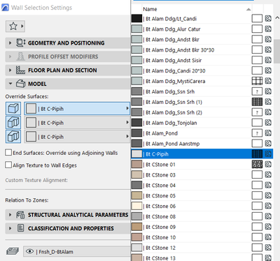

I want to display the surface symbol for natural stone but it doesn't appear in elevation, does anyone know the problem?
I've completed everything, and I don't know why it's still not showing up

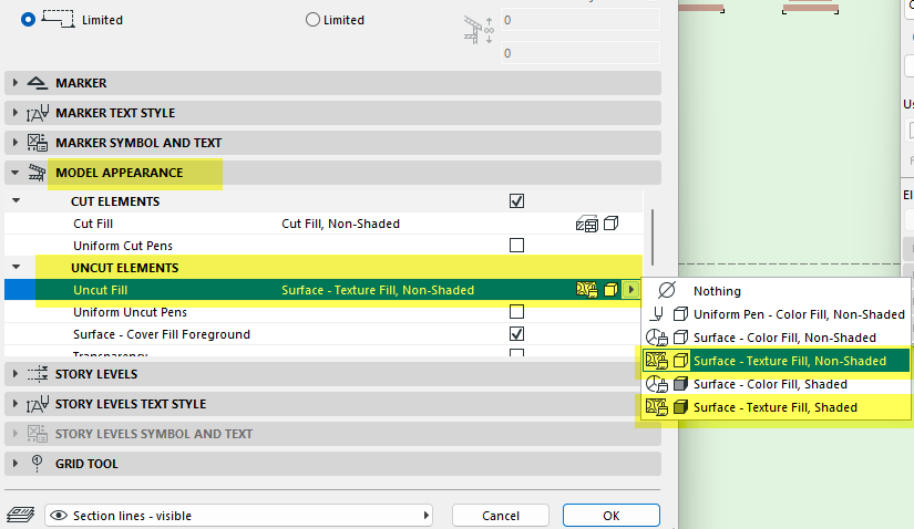

In your elevation settings, do you have the uncut fill set to show surface textures?

ok thats work, thank you so much
