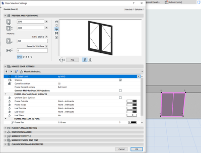

Hello. I have one file where I cannot get my doors / windows to display properly in 3D according to my MVO settings. The issue is that in 3D view, they all appear as 'simplified', regardless of my MVO settings. I have used this function without issue in all my other projects so I'm fairly certain I have my settings as they should be:
  • Hinged door settings > Door settings and openings > Detail level > 3D detail level > set to 'by MVO'
  • Hinged door settings > Model attributes > 3D detail level > set to 'by MVO'
  • Hinged door settings > Model attributes > Override MVO for door 3D projections > box is NOT checked
  • Document > Model view options > Detail level of door, window, etc... > 3D and Section / Elevation > Full
In addition, I have the following observations:
  • The MVO overrides are working as they should in elevations. It is only 3D view that is not working.

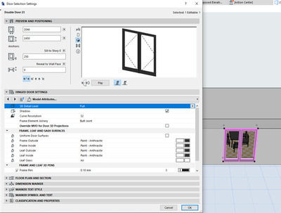

  • If I manually change the 3D detail level in the door settings, (e.g. to 'Full') they display properly in 3D
Screenshots of my MVO settings, and door 3D detail settings showing 'Full' vs 'by MVO' attached.
I'm not sure what else to try or how to troubleshoot this further. Any suggestions? Thanks in advance
Archicad 23 Solo, Dell Precision 5540, Windows 10 Pro, Intel(R) Core(TM) i7-9750H CPU @ 2.60GHz 2.59 GHz, 32GB RAM

Hi Lee, thanks for your reply. Yes the Quick settings is set to the correct MVO, as is the view in navigator.
I have also checked the issue by setting up different MVO parameters - one for 'full' and one for 'simplified' and changing between them whilst in the 3d view. As predicted, nothing happens. When I do the same thing in elevation view the overrides work as they should.
This indicates to me tells me that I have everything set up as it should be, and there is something that is preventing the MVO from working properly in the 3D view.

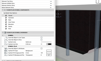

I have a similar issue - but with Railings.
I have created a new MVO and set the detail level to be full. It's always railings.
In fact railings always create problems for me in AC25.
Seems to be just a Mac-specific thing. It's a chronic problem because restarting AC doesn't fix it.
Archicad 28 UKI | OS X 14.7 Sonoma
Are you sure the railing issue is not a Graphical Override or Renovation Filter Override?
Railing components can have different renovation status to the actual complete railing.
Jim Allen
Yes - I've checked everything. Changing MVOs doesn't seem to change the display, so I think it's a file-glitch. The file originated from a template from AC25, so I suspect there might be some random weirdness introduced.
I do get these from time to time, and they don't manifest on colleagues' Windows machines.
Weird.
I've cut and pasted the geometry into a new file (MVOs and GOs are almost never modified) and it's working fine now.
There are so many little settings and subtleties in Archicad that it's easy to miss stuff. I also checked the renovation filters.
