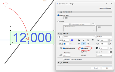

Hi all,
I've just installed Archicad 27 3001 NZE Full.
I've noticed that when I create a Dimension object, with Text Style set to have an Opaque background, the text box appears behind the dimension line (as per attached image).
This behavior is not what I have come to expect. Is there a toggle or option I am missing?
I am aware of the Within Line option, but this is not what I am looking for as it does not behave as I would expect with my current workflow (for example: if I want to manually relocate the text box due to clashes with something else in the drawing).
I tried to edit the Display Order, but this setting does not appear to apply to Dimension text boxes.

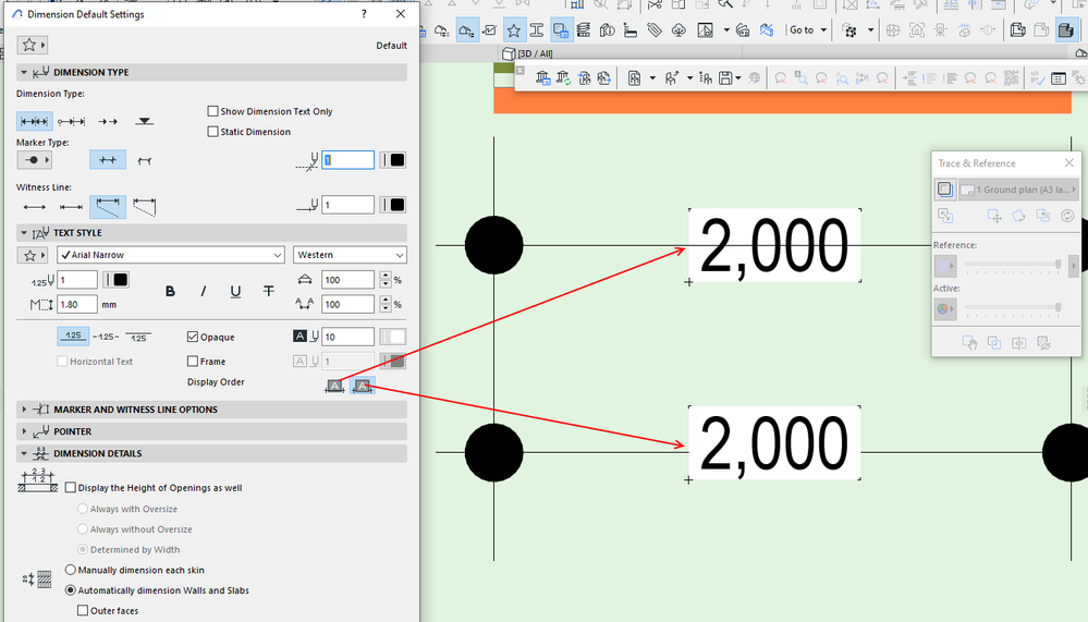

Select the dimension line and not just the text and there will be a display order setting.
Yes, that's it.
Thank you, Barry!
