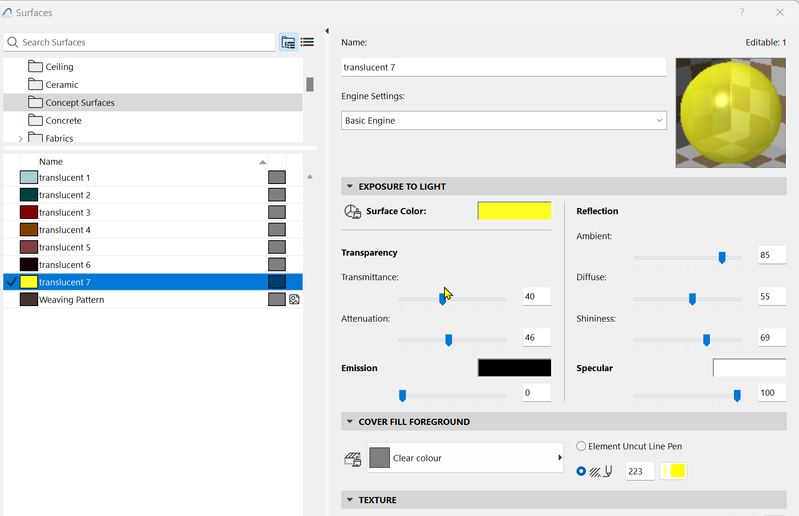

Can't get slabs to display cover fills with pen colour as defined for surface foreground fill
I am almost certainly missing something obvious, but cannot seem to get placed slabs to automatically appear with cover fill pencolour reflecting the used surface cover fill foreground pencolour.
I am essentially trying to create some 3D diagrams where placed slabs display as blocks of the same solid colour whether seen in plan view or 3D - without needing to manually set individual slab's cover fill pen colours to match each time.
The surface definitions I am using have an associated blank cover fill, set to 50% opacity, and a defined fill foreground pen colour that is similar to the surface colour
However each placed slab is having its cover fills dictated/overridden by its own individual cover fill foreground and background pencolour settings.  The pencolour set for the cover fill foreground in the surface definition is being ignored, even when 'use fill from surface' is ticked
I want each slab to automatically change colour to match whatever surface they are given.
This is in a plan view without any active graphic overrides or renovation filters, and where the penset in use  is the same one in use when defining surface fill

Hello Paul,
When you check "use Fill from Surface" it will use only the fill from the material, not the Pens.
The Pens are then always overwritten by manually adjustable ones. (black in your case)

alexliz
Hi Paul, reading what it states in the Archicad 27 Reference Guide p. 347 (see also here) it looks like the settings you can adjust in the 'Cover Fill Foreground' section of the Surfaces editor affect how the surface will appear in the 3D window, and only when on a 3D Style using the Vectorial Engine.
It would be a nice feature if these settings could also affect plan view, ie if they could be allowed to come through to the 'Floor Plan and Section' area in the Slab Settings dialog, under the 'Cover Fills' section ― or if the 'Use Fill from Surface' option had a further option to, say, 'Use Fill Foreground Pen from Surface', too.

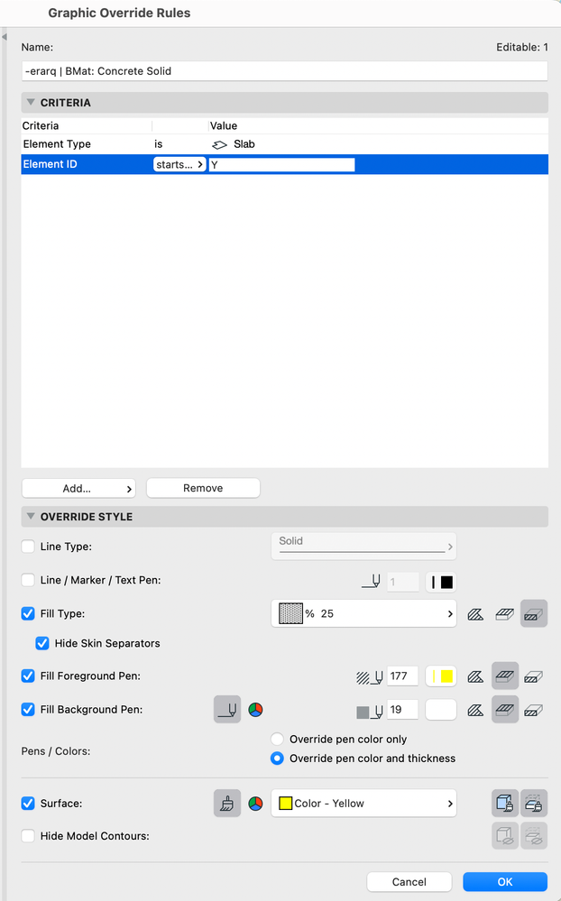

Eduardo Rolon
My workflow for this I would be:
  1. Assign ID per color, ie "Y01, B02, etc"
  2. Use GOs to override Surface using "Element ID starts with…X" and forget about the vectorial engine.
If the IDs don't work then I would use a Property to assign a specific "ID" and use that as the GO base.
