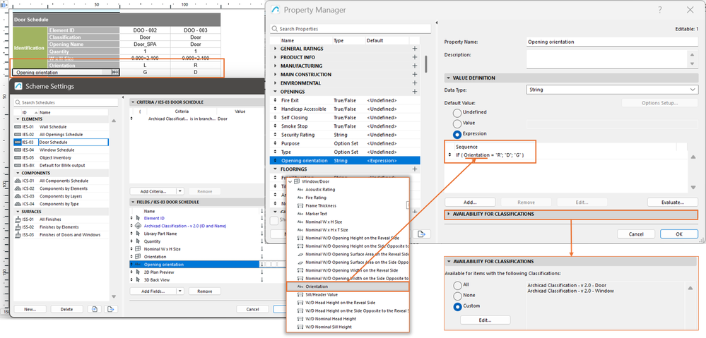

2026-03-10 03:16 PM
You can create a new property available for doors/windows with a conditional expression. In my case the default values for Orientation are: "L" for left and "R" for right so if Orientation is "R" then the value should be "D" else "G". Your expression could be: IF (Orientation = "E";"G";"D")
