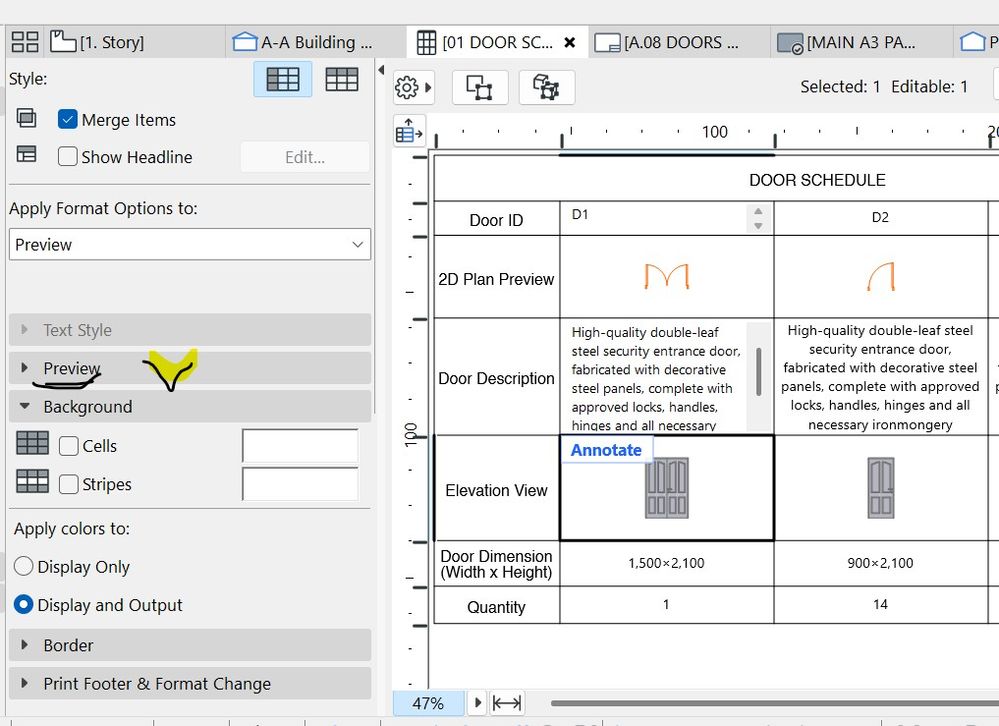

In Archicad 28, I can't click the preview button and drop down arrow to select automatic dimension for the 2D plan and 3D Front View when I  click on them in the schedule. What exactly can i do?

I can click on the plan and elevation view of the door, the problem is that I can't click on the preview button on the left hand side to bring out the drop down option where automatic dimension is tucked in just as in highlighted in the image below.
It still doesn't respond after closing and reopening the schedule on a fresh tab, creating new door schedule or even closing and reopening Archicad as a whole

This behavior can occur when there is insufficient screen space because the screen resolution is too low, for example. At a resolution of 1024 × 640 or lower, larger tabs, such as the Preview tab or the Text Style tab, may not open because they cannot fit within the available screen area.
As outlined on the System Requirements page, the minimum recommended display resolution for Archicad is 1440x900; lower resolutions may result in visual limitations such as this.
The same issue may also occur when the Archicad window is too small, so I recommend checking whether the tabs become available when Archicad is maximized or used in full-screen mode. Increasing the screen resolution (if possible) or testing with an external monitor can also resolve the problem.
