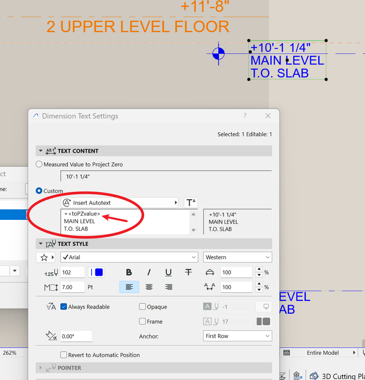

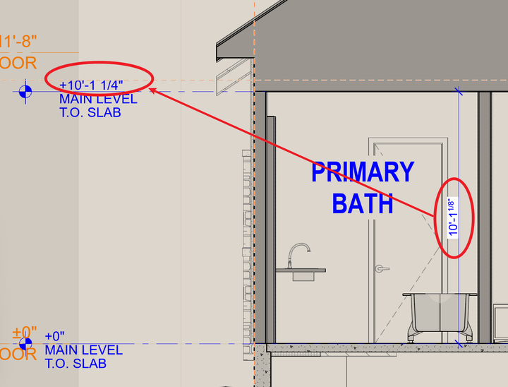

I have   +<toPZvalue>  set for automatic datums for sections and elevations.  Does anyone know why it rounds up to the nearest 1/4".  It will not do the 1/8" per the height of my wall (10'-1 1/8").  The dimension tolerance setting is set at 1/8". I tried 1/64", but still doesnt work.  Is there a seperate tolerance setting for values? +<toPZvalue>.
I need the +<toPZvalue> to show 10'-1 1/8"  NOT 10'-1 1/4".  Please help.  Thanks
Operating system used: Windows 23H2

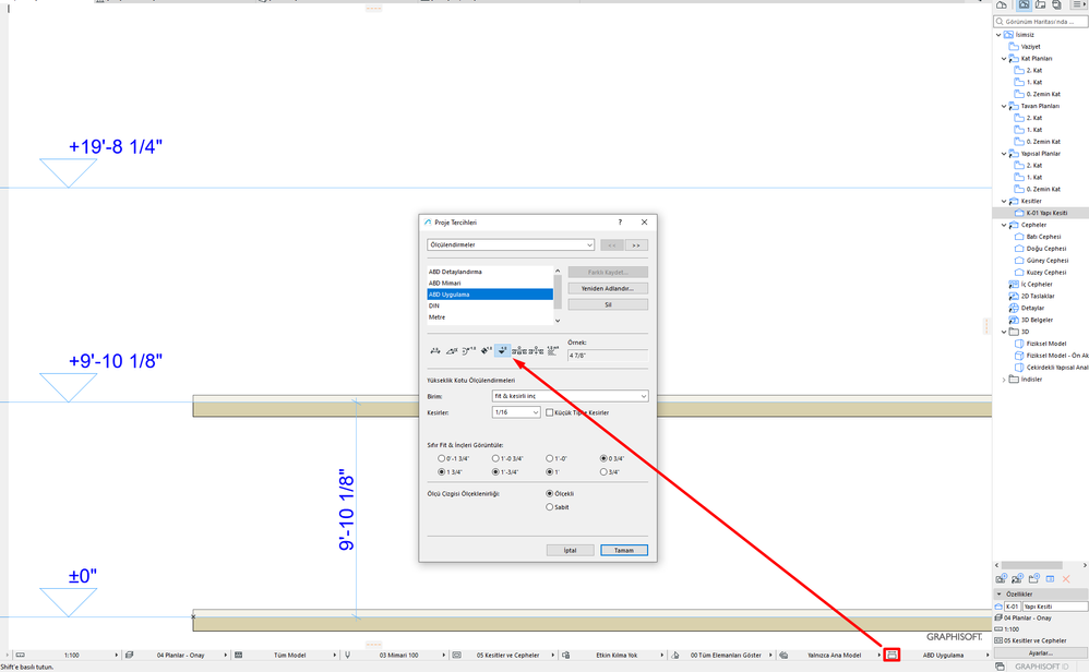

Have you tried clicking the elevation dimensioning button in the dimensioning settings to set the necessary tolerance settings? If you set the tolerance for linear dimensioning, it will not affect the elevations.
There doesn’t seem to be a problem in the test I tried in the screenshot I sent.
Br,
Sefa

Perfect - Thankyou
