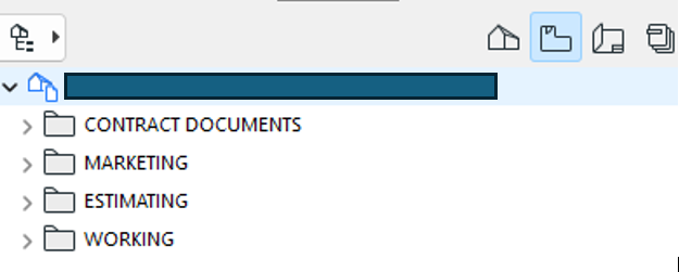

You do not have to use your working views for output views
I have working views-with different colours and layer combinations, etc. to allow easier input and editing,

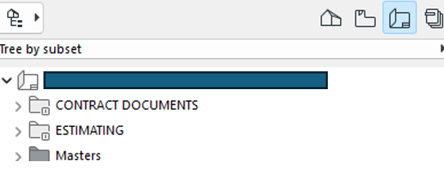

in the same file i have views for contract documents(final "WYSIWYG" placed on layout sheets)
in the same file i have views for Marketing
in the same file i have views for Estimating(placed on a different layout book subset)
BIM means you can have a lot more information in a file than what you present on your layout pages, which allows for lots of differnt information to come from the same file.
if all you are doing is putting lines on a piece of paper then you should just be using ClarisCAD, lol.
i hope this helps.
